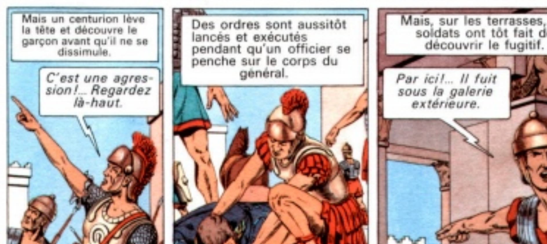

Except, i have a problem with some pdf which are not rendered well.
Let me explain myself, the pdf file is nice, good quality, super readable :
here
But in my yac library (and in yac reader on my ipad), the quality is unreadable (first time a pdf does this :( ) :
here :(

And it’s unreadable even on my windows machine using YACReader :( (but totally fine using a pdf reader or cdisplayex.
It’s when imported in my library that the problem occurs I think.
2 years 4 months ago - 2 years 4 months ago #8506 by LethalWeapon
Replied by LethalWeapon on topic PDF render quality problem
I confirm the problem :

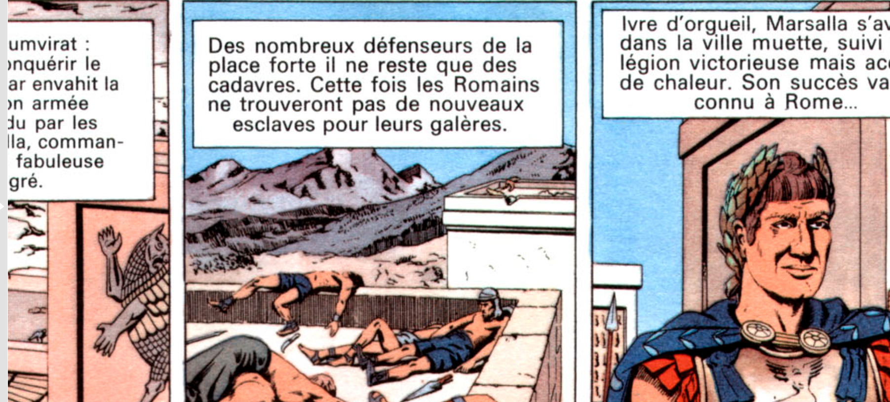

2 years 4 months ago - 2 years 4 months ago #8513 by LethalWeapon
Is no one interested in this problem?
On my previous post, you can see the blur when reading with YACReader on the first image. On the second one, the reading is done with Foxit PDF Reader and it's perfect. It's also fine with CDisplayEx and PDF-XChange Viewer or STDU Viewer.
I have countless files with problems, but on others it's fine, but not as good as CBR or CBZ.
It's vexing to see that these files look good on any PDF reader, but not on YACReader, which is by far the best for Comics, especially in combination with YACLibrary.
